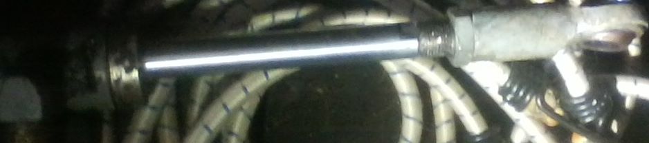

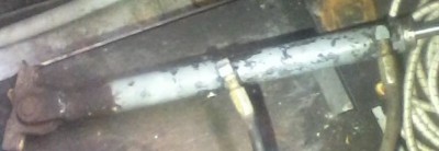

I have searched every web site that carries Tele-flex, SeaStar, etc... and cannot find a cylinder that looks like mine. I would much rather rebuild it with a new seal kit since the prices I have seen for new cylinder range from $500-$1000 !!! But I don't know what to buy anyway ! The cylinder has been repainted twice, and the sticker, part number, data tag are long gone. Is this thing so old that these parts are no longer available? Will I have to re-design it for a newer system?

Jim.. you are one hard working Marinette mechanic!! COngrats on the updates so far. On the steering question, take a few sharp pictures (the ones you posted are soft focus) and contact the support folks at Hynautics (or their successor). From what I've heard, they are anxious to help and the last time I saw their web site (some years ago), replacement parts were available. There hasn't been much change in the technology. Good luck and happy New Year

Look on page 11 of this manual. They only list two cylinders. You could measure old cylinder and compare it with one of these.
http://www.seastarsolutions.com/wp-cont ... 43319J.pdf
Looks like the only repair kit offered for these cylinders is a rod seal kit.
Good Luck

Thank you very much Gentlemen. The pictures on page 11 and page 34 are my cylinder, at least it looks like it. I had suspected that this was a factory set-up, as most newer Hynautics installation kits use that synthetic nylon tubing for the hydraulic lines, where as mine was built with a very elaborate and well thought out copper tubing layout, the craftsmanship of which is very good. No hack conversion here ! As bad as the steering system was, it's a wonder that I could turn the steering wheel at all. I know the photo's aren't the best, but I had to reduce them to these fuzzy images because when I tried to post then, the site kept kicking them out with an error code stating that the jpegs was too big?? (too many KB ?) The rusty end of the cylinder of the upper photo is the ball clevis where the cylinder hard mounts to the hull's framework and that pin is so rusted, it AIN'T movin' !! I tried to work on it yesterday (1-1-16...Happy new year) but up here on Lake Erie, it was 28* F, everything was frozen, and I gave up. Oh well...in the spring.

Kroil or PB blaster work if give time. Now is the time to soak the sh&% out of the frozen pins, :roll:

Good luck, once again proof that lots of time and money to fix most things. And you are better off to do it yourself because it's impossible to find a good mechanic. Wanted to warn you to make sure the copper lines are all isolated from the aluminum of the boat. You will have bad corrosion right away if they touch. You can get aluminum tubing or stainless if you want to change anything. Use lots of grease or zinc anti-seize when you put it all back together.
I know about pics being too big. I use shrink pic to make them fit. You did good to get any pics included. Everybody fights with it. --Ed

Almost forgot that I started this post !! Thanks to Bill Cassedy for bringing the subject back up, so I will update what I accomplished. Rob, the fella in Dayton, did a beautiful job on the stainless steel rudders, craftsmanship was spectacular. Put them in with new packing glands & GFO packing...My bilge is now DRY !!! The steering cylinder was, as I figured, so old that no parts or replacement cylinders were available. Luckily there is a place close by where I work (in the Cleveland area) that sells hydraulic seals for every cylinder on planet earth. So I went ahead & rebuilt it myself. I replaced the worn o-ring seals with the much better X type "Quad-ring" type seals. Shouldn't ever have to fix it again. (hopefully) Bead blasted & polished all the machined surfaces & repainted the outside of the cylinder. The pivot bearing, that mounts the fixed end of the cylinder, was easily located from an online bearing company (it's used literally on hundreds of industrial machine applications). All said & done, probably have less than $400 in it, that includes the stainless rudders ! I did luck out as far as the bleeding procedure goes, since I only had the cylinder off, it didn't take much fluid, or work, to bleed it out. Bought a little foot operated bicycle tire pump, to air up the hydraulic reservoir, and it is small enough to keep on the boat with the rest of my tools. Sandblasted, polished and painted all the remaining parts and gave her a "rear end alignment". Steers straight and you can turn the wheel with your finger.
