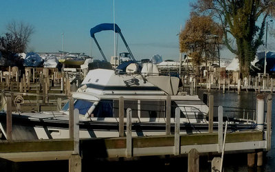

Moving up to a 1973 Marinette Fisherman 32 from my 1968 28' Marinette Express. Anyone in the market, it is on a trailer in Southwest Michigan ready for you to pull home $8,000. Cannot wait for next Summer to get into this new boat, well new to me boat.
