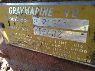

Thanks - Its a 215, but not sure it started with the 4bbl on there. Goal is to have it ready for next season. Love those Buick 215 aluminum engines. Think I saw your youtube video on that one. Will post some pics once I get going on it.

Sure looks like an AMC.

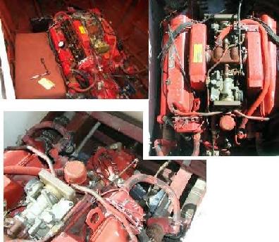

Check my photos--and they are definitely an AMC. Could "215" be the horsepower?

Hey! The distributor is in the wrong lace for a 215 Buick; it should be in front, in the timing case. An AMC has it in the back (like a Chevy).

Mine is a 327, not Buick. I have seen the AMC engines with the flywheel forward, and aft. I think the 215 was the original HP rating according to the chart I found. I do not think the 4bbl intake and carb are original. Wondering whether to keep the Transmission with the gear reduction, or go with a standard 1:1.

Yeah confusing. Gray Marine named based on HP. My 215 CID Buick Motors are called 160's by Gray Marine becuase that is the HP.
