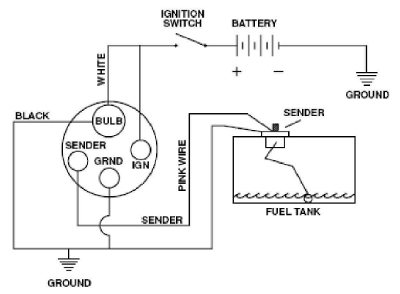

Re: Fuel gauge sending unit
heres a basic wiring schematic.

Thanks supersport18 for the testing procedure and schematic, I'll definitely check that out first and hopefully I'll be one of the 90%. Yooper, your research was a big help. I hope I don't have to replace the sender, but if so, I'll check with Jamestown Distributors first.
