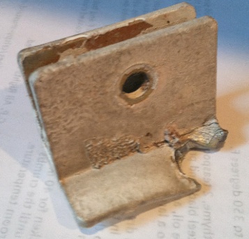

Anyone know where I might find replacement brackets for swim platform? See pic.
Untitled 3.jpg (47.3 KiB) Viewed 12108 times

Have made a local welding shop.

Happen to know alloy spec? I'll weld up myself. Thanks RB

use 5052 to 6063 that's what's listed as marine use.

Rivetman wrote:Happen to know alloy spec? I'll weld up myself. Thanks RB
:) Found this in a old Marinette brochure.
"Marinette Cruisers are made from the aluminum alloy 5086."
