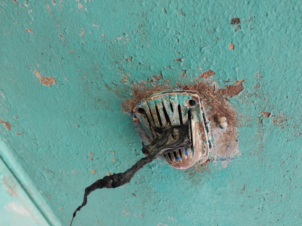

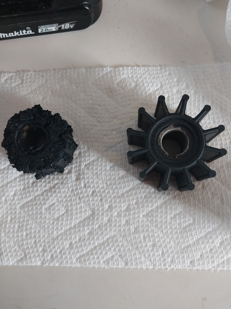

There's a lot of grass in our river this year, and sheared off pieces of it floating in the water. I got a plugged cooling water intake on one engine while going through a pair of big locks. Overheated that engine and shut it down when blue smoke billowed up from the exhaust. I tied up to the canal wall to let the engine cool off and assess. The external engine temp registered 240F with my handheld laser. The water pump was toast. Engine cranked and started. Sounds like the rubber muffler is damaged as well. The engine paint is not discolored. The sherwood water pump is. All the fingers on the pump impellers were gone, ground into little pellets.
I couldn't clear the strainer from inside the boat. It is the original dished plate with slots cut in it, mounted on the underside. I am only assuming it is plugged with grass at this point. I don't have strainers inboard. I had some hose so I tied in to the other engine intake with a tee I had put in for winterizing. A quick replacement of the sherwood impellers made the water pump run. Needs a new shaftseal though, water was spraying. Anyway, it got me the last ten miles to my home port with both engines. Haulout will answer the grass question. This old guy isn't anxious to dive if it can be avoided.

Here is the ooze that killed engine #1.

For anyone who has not seen the inside of a Sherwood pump, here's one of the toasted impellers on the left, a spare on the right.
My engines didn't have a temp switch. They will in future. Fortunately, I looked back and saw the exhaust smoke.
