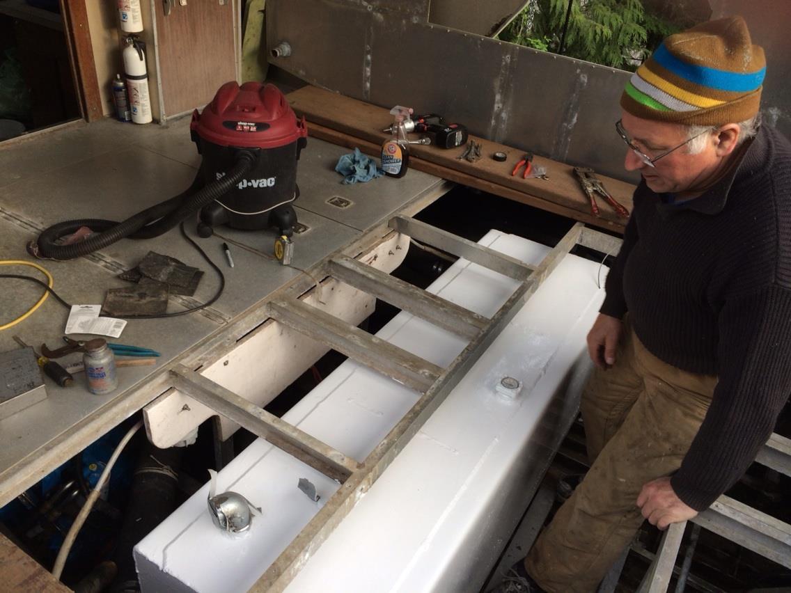

New tank put in through the rear hatch.

In your photo It looks like you are using one tank, placed across the boat. Am I right? Secondly, what did you do to remove the old tanks?

The older models had one tank like Busia's, and the exhaust ran on the side of the hull. Newer models had 2 smaller 75 gallon tanks on the side of the hull and ran the exhaust in between the tanks and had a 45 degree elbow before it exited the hull. If you go to a one tank system, you will have to account for the exhaust changes. I removed my 75 gallon tanks through the rear hatch after draining all the fuel out, removed all the hold down brackets, and removing the exhaust. There was not much room, but they did make it out of the hatch. I myself would go back with the two separate tanks. Get the dimensions and decide if you are going to go with aluminum or poly, then google them and get the closest size you can that will still fit through the hatch. Great Lakes Skipper had quite a few different options the last I looked. Good luck!

Yes, I had one tank. I had a new one built out of 3/16" aluminum, larger than the original. I removed a couple of braces for the floor to make the opening as large as possible and had the tank made just a bit smaller. I would never go with a plastic tank for gasoline as they will build up a static charge and discharge with a spark. They do make some plastic with added carbon that will conduct electricity and can be grounded.
I put 350 Crusader engines in mine, with 4" exhaust so I could not slide the tank as far forward as before. If you get a tank made, make sure they weld a tab on it so you can connect a ground wire to ground the tank. I also added a port on the top corner with a plug in it. Every spring I heel the boat over so that corner is the low point, pull the plug and stick a 1/4" copper tube through the port to the bottom of the tank. I can then pump the bottom of the tank out and check for water on the bottom. I have found that even if they don't tell you that the gas has alcohol in it, it does. Lots of alcohol in it. It will absorb the water and cause many problems.
To remove the old tanks, just pump them out, disconnect any lines and remove them out the rear hatch.

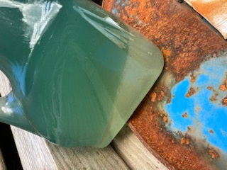

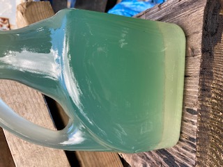

I will try to show some pictures from my phone here. They are what I pumped off the bottom of my fuel tank. The gas looks blue from an additive to help with the alcohol in the gas. I will drain the tank and start the summer with new gas.

That looks like the dreaded Whote Gook that is created by ethanol gas and cannot be burned by any known additive. It's also corrosive.
