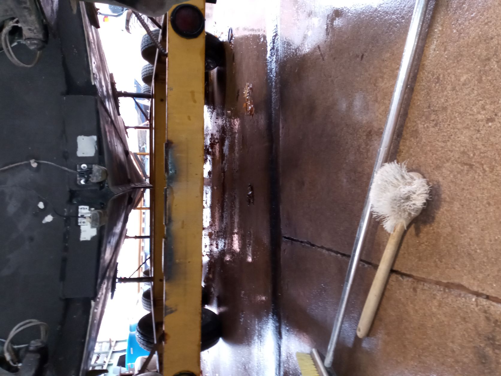

Here is a shot of the bottom with all the shaft, rudder, strut, and old transducer holes welded up. With a couple of brackets welded in the center for transducer install without piercing the hull.

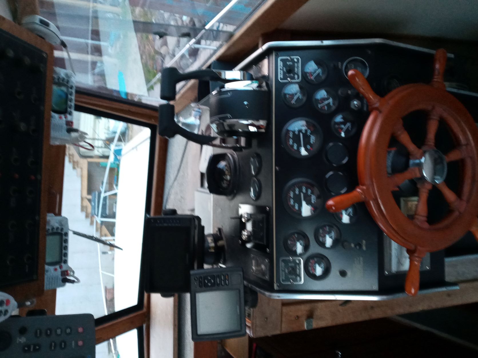

Re: A little crazy?
Here is the new control for the engines after some re-configuring. I had saved the old wheel off of my 28 before I sold it and installed on this boat. I like the old wood spoke wheel versus the newer destroyer style stainless wheel.

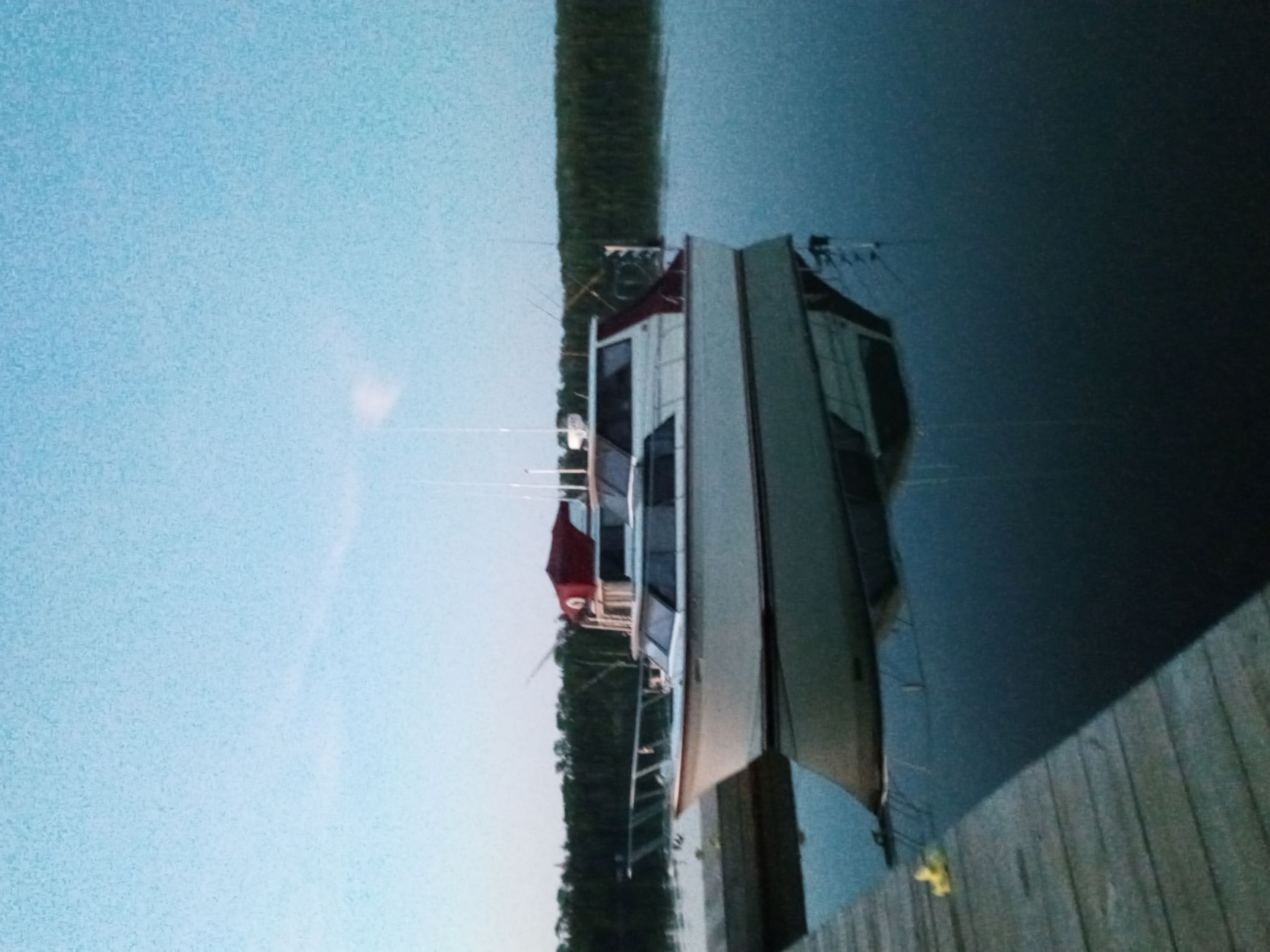

- Posts: 236
Re: A little crazy?
Here she sits in the water at Isle Royale National Park during the end of July. Note how little she squats in the stern with the new set up. With full fuel tanks, it sits around 2 to 3 inches deeper than before the conversion.

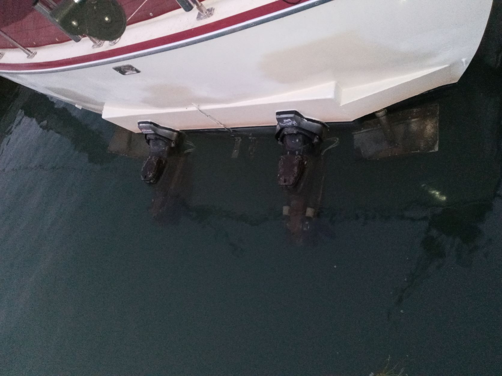

Re: A little crazy?
The first launch was on July 9th, we had run it up and down the canal we are on, but I could not trim out the outdrives at all, they would start to ventilate/cavitate right away with any trim, It would also lose bite in a hard corner. Pulled boat out the next day. I had left the original trim tab mounting flanges on the hull, but had also welded an extension out to the chines so I could move the trim tabs out to the sides of the stern drives, thinking that they would not hinder anything. After looking at probable causes for the ventilation, I cut off the original mounting flanges that were left in front of the drives, and cut the trim tabs down a little more. This helped a lot. I can make a hard left or right hand turn now at full cruise and not have any slippage. I still can't trim up as far as I want to yet, but I am making progress.
