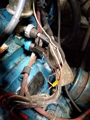

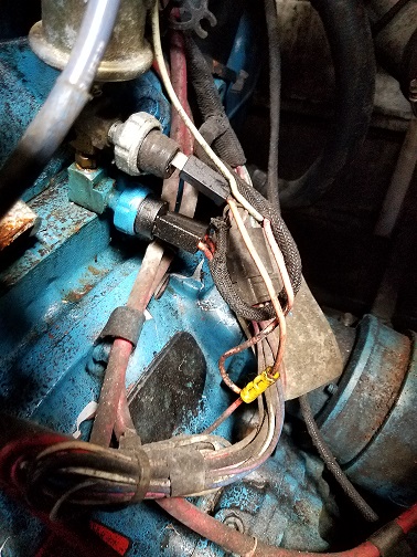

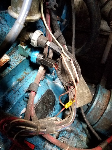

The location of the oil pressure switch is at the rear of the engine. Back in 2018 I was going to switch to an electronic gas pump. Part of the process requires an oil pressure switch be electrically in line to the pump so that, if the engine should die (or just the ignition be left energized - engine not running) the oil pressure switch would open, breaking the circuit to the gas pump (and preventing a flood of gas spewing from the carb - bad thing!
). This is a pic of the "stack" of pressure switches. Your original one would be first (second?). The 3rd (top - canister) is the one I added - but ultimately didn't need as I located a source for the mechanical pump and used that.
Note - I did try removing the original switch but it seemed I'd foul up the threading / break off the original switch in the process. Opted to just "stack" the new one, which has worked well (it's just sitting there, not being used - the engine, other oil switches below, and gauge don't seem to care.
