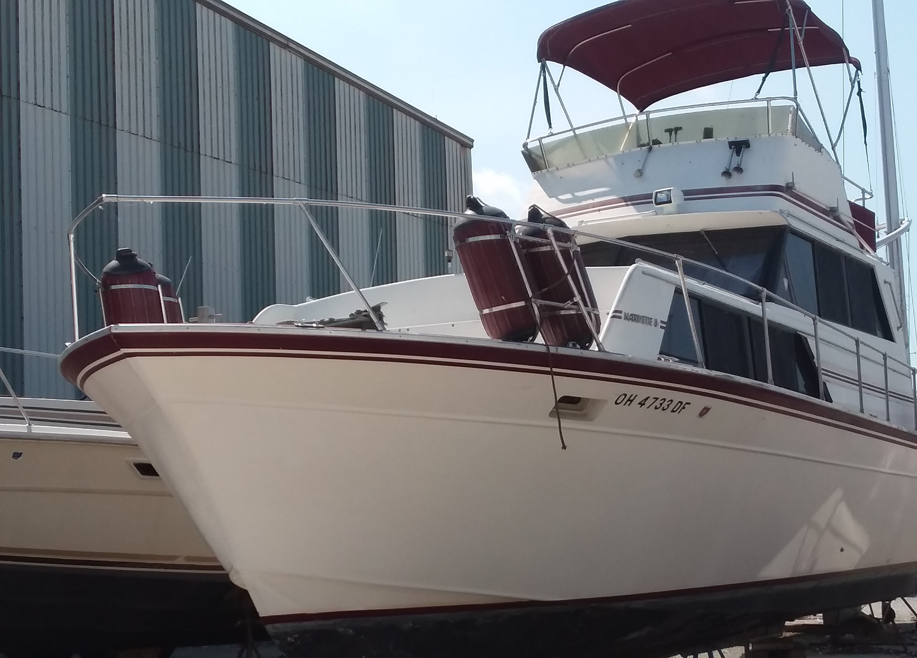

I bought my 1987, 32 Sedan-Bridge "KOKOMO" last August. It was in the water when I took delivery. ( After the sea trial ) And it had a set of 3 blade props on it.. However, along with the boat came a brand new, never in the water, set of "bronze looking", 4 blade props for "spares".. I have twin Chrysler 360's, with electronic ignition, and two, 100 gal. fuel tanks ( side mounted )..
My question is this:
Which prop set is better, and why.?
What will I gain, and / or loose, if I put the four blade props on it.?
If I get better control in the marina, and in / or out of the slip control, with the four blade props, but give up a little top end, thats a trade I might benefit from.. But if the trade off is way more fuel burn for the same speed ( RPM/KPH ) then keeping the 3 Blades may be the best answer..
What do you all think.? What do you use, and why.? What has been your experience with 4 blade props..?
I splash next week, so any help is greatly appreciated...
Thank You..
