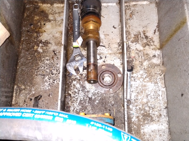

Only pics I have are from pulling the flanges and swapping in New shaft log hoses.

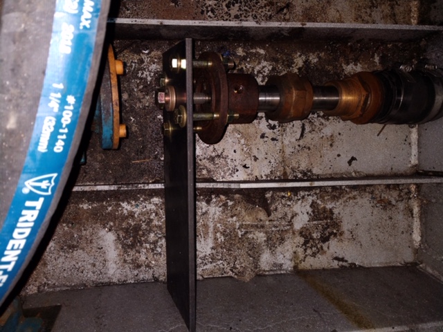

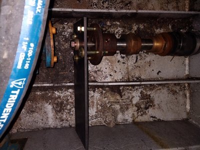

Is it just me or does the engine alignment look way off?

Post by Lincolncruiser95 »
Lighting and sideways torque from pulling flanges. Once I pulled the shafts back into the boat I was able to line them right back up. This was taken months ago.
