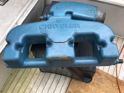

That would be great EW. I only need one at the moment. Attached is a pic of what I have. Its from the reverse rotation engine port side.

Unfortunately you have the less common manifold that was only used in the last few years of Chrysler Marine production. I do not have any of those manifolds but I believe they are available new at just under $500 each.

That may be able to be welded. I had one repaired at this place in Cleveland:

That's the same style I put in my 74 318 when I converted to FWC. That's a Barr Marine CM-1-4417063 Manifold available here for $326.99 new
