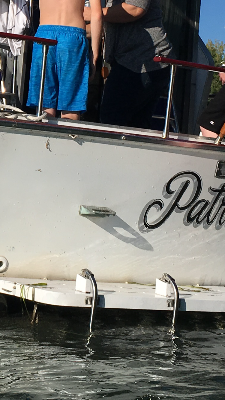

Using a simple hack-saw, I have cut the aluminum 'railing' between the 2 stanchions allowing me and the kids to enter the rear of the boat from the swim ladder more easily. the railing is hollow, so I used a router to craft an oblong wooden dowel into the open ends of the rail, a little gorilla glue or caulk to secure it, then sand & paint. I still have to decide how to bridge the gap. The railing is surprisingly sturdy. I will have to monitor it more after a full summer of use. Good luck.

What you did is exactly what I was planning on doing. I plan on welding a plug in the cut ends and installing a hinge to flip the railing up onto itself. Are your stantions aluminum or stainless?

I had a similar idea, and it looked really nice for a week, but I made the mistake of purchasing cheaper stainless hinges. My daughter went to open it (the wrong way) and it bent the hinge, the railing came off, and ended up at the bottom of the marina :-(. All is well though -it was a mistake I can afford -in the safety of my marina on a non-moving vessel.. had it happened while underway, I could have had a dangerous accident. Lesson... spare no expense to secure and support the railing when it’s in the closed position for safety reasons.
