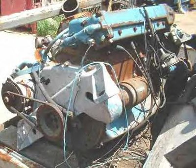

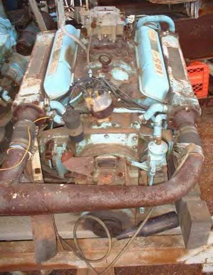

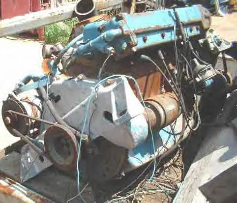

Oh God! I thought all of those confusing monstrosities were melted down for scrap by now?
For those of you who never seen one of these beasts, the drive is off the nose of the engine with the distributor mounted on a housing on the flywheel end (that spins in the breeze!) Try figuring out which way is the 'normal' rotation on these and which is reverse! It's hard enough with "normal" engines!
PS: For you knowledgeable SB Chevy guys, note where the parts are located. The goofy plan was to lower the motor a few inches by having the oil pump forward. Arrrrgh!

If you go look at them, you will understand. I believe the pictures that Jeff posted are early Q engines. The later ones fixed some of the weirdness, but added some new weirdness. If you compare a Q and F side by side, you will see that there are lots of little things that would need to be modified to use a standard intake.
