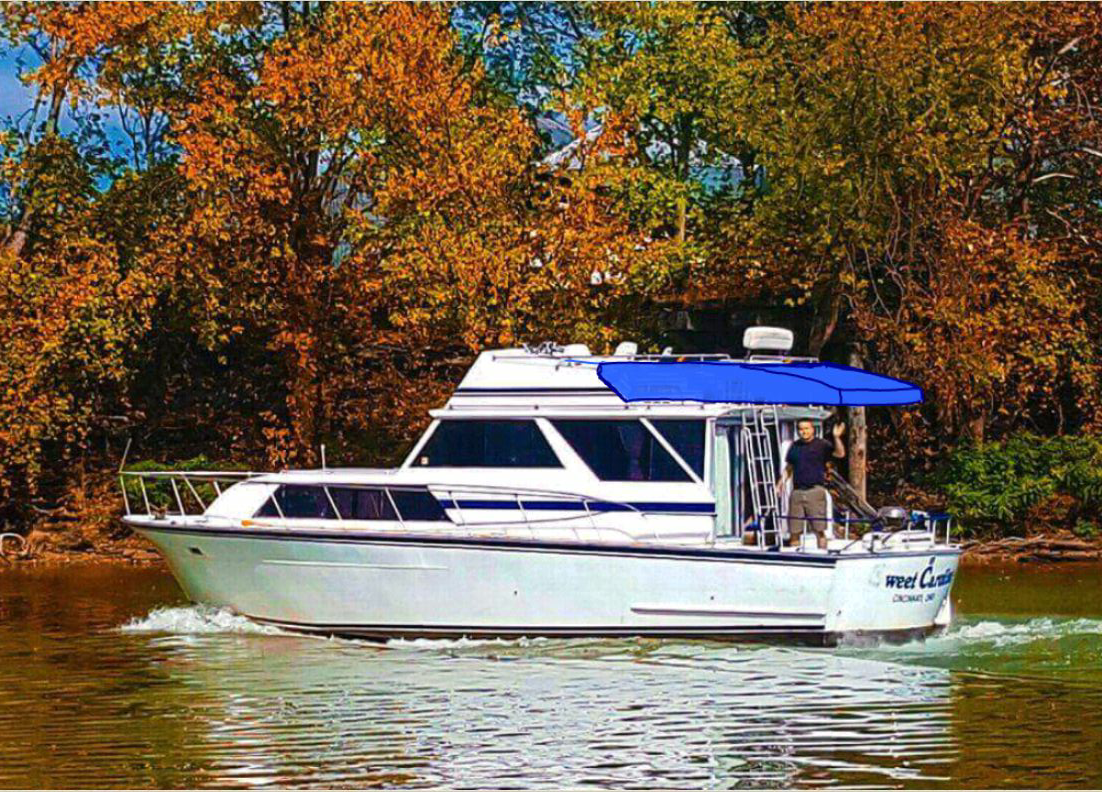

I emailed back & forth with John in Louisville Ky (his boat is named the Knockerfellers) and he sent me pictures of the building of the top. He performed this while repainting his boat, and yes it not only looked great, but looked factory since he used the roof off another M. I'd love to do the same thing to mine, but finding a roof from a scrap 37/39 may be a bit more difficult. Photo's of his project were in the photo archive of the old site, so I'm not if they can still be accessed.

I have seen "Knockfeller" out on the river, actually followed him up the 18 mi Island channel and .... Yes! That is an impressive and very well done modification.
Nice colors on the boat as well!
