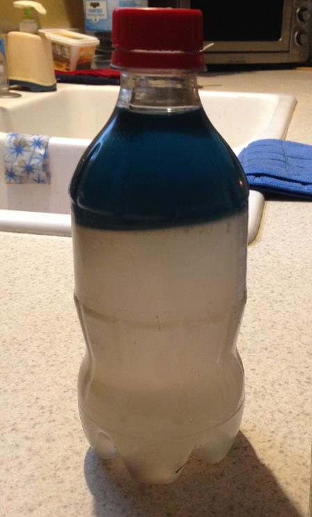

PS: If you didn't insist your fuel is beyond suspicion, I'd swear you have water in your gas. I bought 4 gallons of gas from my local gas station and there was 3/4 of a Coke bottle full of water in it! You never know...
