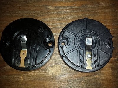

New Rotor on Right
New Rotor on Right
Rotor on the Right is the re-designed on. Instead of a rivet there is not a screw. Also notice the different style of pickup spring and different shape of the rotor contact.

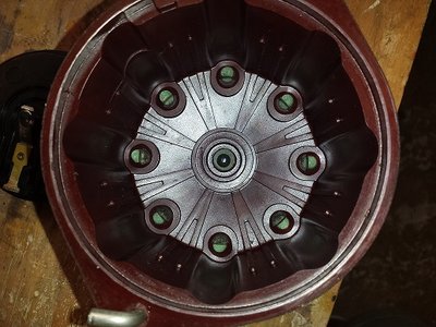

New Designed Cap 617.jpg (35.33 KiB) Viewed 10723 times
New Cap.
