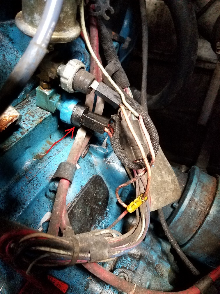

- on the rear of the engine is/are what I believe to be an oil pressure switch (see photo).
-> Am I correct? ( the 2 wire connected device - RED arrow on pic)
- If so, it appears that this is already in use for some functionality on the engine.

--> I would then believe I'd need to:
a. find another location on the engine to install a new NO oil pressure switch -or-
b. install a "T" at the current location, reinstall the current oil pressure switch AND install a new NO oil pressure switch.
--> is "b." doable / workable?
I'd think the installation of my current ignition type switch (OFF - ON - MOMENTARY ON) would function as Jeff indicates.
ie. In MOMENTARY ON - the oil pressure switch scenario is bypassed to allow for priming the carburetor. Engine not cranking.
In ON - the ignition switch is now activated, cranking the engine. As oil pressure builds during cranking (and resulting engine run
the fuel pump is activated, sending fuel to the carb normally.

Bill..I know this isn't exact responsive to your query - Jeff is THE man on this issue - but just wanted to pass along that I think the unit directly above the one you marked is the oil press alarm. I'm just writing to suggest you have a spare or two of these things because they're a failure point for major oil leakage. They love to crack for some darn reason. Happened to me twice and I was lucky a) to have caught it very early and b) have a couple of spares thanx to the first owner.

The oil pressure switch (not the pressure gage sender) has two wires on it.
Think of it as an automotive idiot light switch (which is what it's used for): Oil pressure opens the circuit and the 'light' goes out. With no oil pressure, the circuit closes and energizes a relay to shut off the 'light'. The 'light' in this case is the electric fuel pump. You'll need a Borch type relay to run the pump (eBay--cheap). The oil pressure switch is tied into the coil energizing loop of the relay so the fuel pump will stop when the oil pressure drops. I used the ground side of this circuit (through the oil pump switch).
On my old boat, I rigged up a momentary switch to run the fuel pump(s). When the boat sat a while the carbs were empty, thanks to fuel evaporation. Ten seconds on that momentary switch ran the e-pump(s) long enough to fill the carbs, resulting in a fast fire up. Worked slick, and it's CG legal.
PS: I can publish the circuit diagram if you need it.
