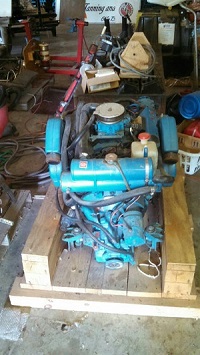

Post by Leviathon »
Holland Chrysler b.jpg (40.56 KiB) Viewed 13915 times
Trying to figure out how to add a pic
