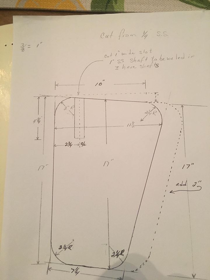

IF you build large rudders, which I think is a good idea, be sure to copy and enlarge the shape of the present ones.
The amount of metal on each side of the post determines the balance and is CRITICAL to proper steering feel.

Roger Brown was nice enough to upload a design of rudders for his 37. But the design goes against what you just said. I've spent my day beating my rudder with various sized hammers and trying to get that arm off of the rudder. I'm close, but my puller quit working right as I got it almost off. Left it soaking in penetrating oil over night.
Once the rudder comes out I will be able to tell if it is something that is savable or a definite replacement. If I have to design a new one I'm wondering if I would have to do both? This is not a fast boat. And the starboard rudder seems just fine.
My goal is to be able to steer the boat on one motor. I agree that the amount added to the leading edge and the trailing edge has to be in proportion to one another but I don't know if the should be equal. Seems to me the if the widest part of the existing rudder was 11 1/2 with only 2 3/4 on the leading edge that one would use that same ration when adding to the existing rudder.

Re: 37 Sedan- Considering LARGER rudders, thoughts?
The balanced rudder takes most of the work out of steering. If it was not balanced (like some early airplanes were built) you have to do all the work, and the rudder would want to go back to center. What you want to do is keep the ratio of the area's the same. So much in front of the centerline to so much behind the centerline. I would not change only one rudder. That would make it handle differently depending which engine was running.
