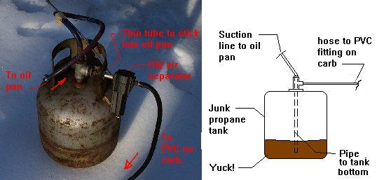

Oil vacuums out of these fairly easily. I used to get nearly every drop out, for they took 6 quarts to bring the level up to full. TO do it, I removed the dipstick assembly from the block and stuck in a 1/4 inch steel brake tube (connected to a vacuum source). Being an oddball tinker, I used an old propane tank for a receiver, and the other engine for a vacuum source. Neat and clean.

Excellent idea. What port are you drawing the vacuum from?
Re: Oil Plug
The PCV port on the carb. I also used it to suck the oil out of the filter, to reduce that mess as well.
