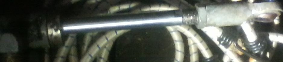

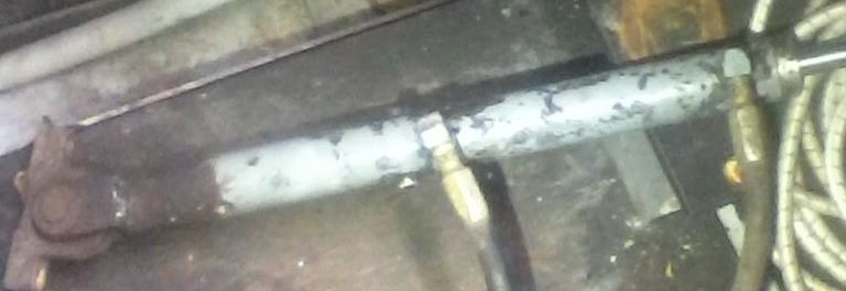

I have searched every web site that carries Tele-flex, SeaStar, etc... and cannot find a cylinder that looks like mine. I would much rather rebuild it with a new seal kit since the prices I have seen for new cylinder range from $500-$1000 !!! But I don't know what to buy anyway ! The cylinder has been repainted twice, and the sticker, part number, data tag are long gone. Is this thing so old that these parts are no longer available? Will I have to re-design it for a newer system?
Hynautic steering

Jim.. you are one hard working Marinette mechanic!! COngrats on the updates so far. On the steering question, take a few sharp pictures (the ones you posted are soft focus) and contact the support folks at Hynautics (or their successor). From what I've heard, they are anxious to help and the last time I saw their web site (some years ago), replacement parts were available. There hasn't been much change in the technology. Good luck and happy New Year
Update: a quick google search found this: http://www.seastarsolutions.com/support ... l-support/
Re: Hynautic steering
Jim it looks like your doing a great job of bringing the old gal back to life.
Well Jim pretty sure Marinette offered Hyd steering as an option.
And Seastar still supports Hynautics. (thanks jralbert)
http://www.seastarsolutions.com/support ... /#cylinder
Look on page 11 of this manual. They only list two cylinders. You could measure old cylinder and compare it with one of these.
http://www.seastarsolutions.com/wp-cont ... 43319J.pdf
Looks like the only repair kit offered for these cylinders is a rod seal kit.
Good Luck
- Posts: 440
Thank you very much Gentlemen. The pictures on page 11 and page 34 are my cylinder, at least it looks like it. I had suspected that this was a factory set-up, as most newer Hynautics installation kits use that synthetic nylon tubing for the hydraulic lines, where as mine was built with a very elaborate and well thought out copper tubing layout, the craftsmanship of which is very good. No hack conversion here ! As bad as the steering system was, it's a wonder that I could turn the steering wheel at all. I know the photo's aren't the best, but I had to reduce them to these fuzzy images because when I tried to post then, the site kept kicking them out with an error code stating that the jpegs was too big?? (too many KB ?) The rusty end of the cylinder of the upper photo is the ball clevis where the cylinder hard mounts to the hull's framework and that pin is so rusted, it AIN'T movin' !! I tried to work on it yesterday (1-1-16...Happy new year) but up here on Lake Erie, it was 28* F, everything was frozen, and I gave up. Oh well...in the spring.
