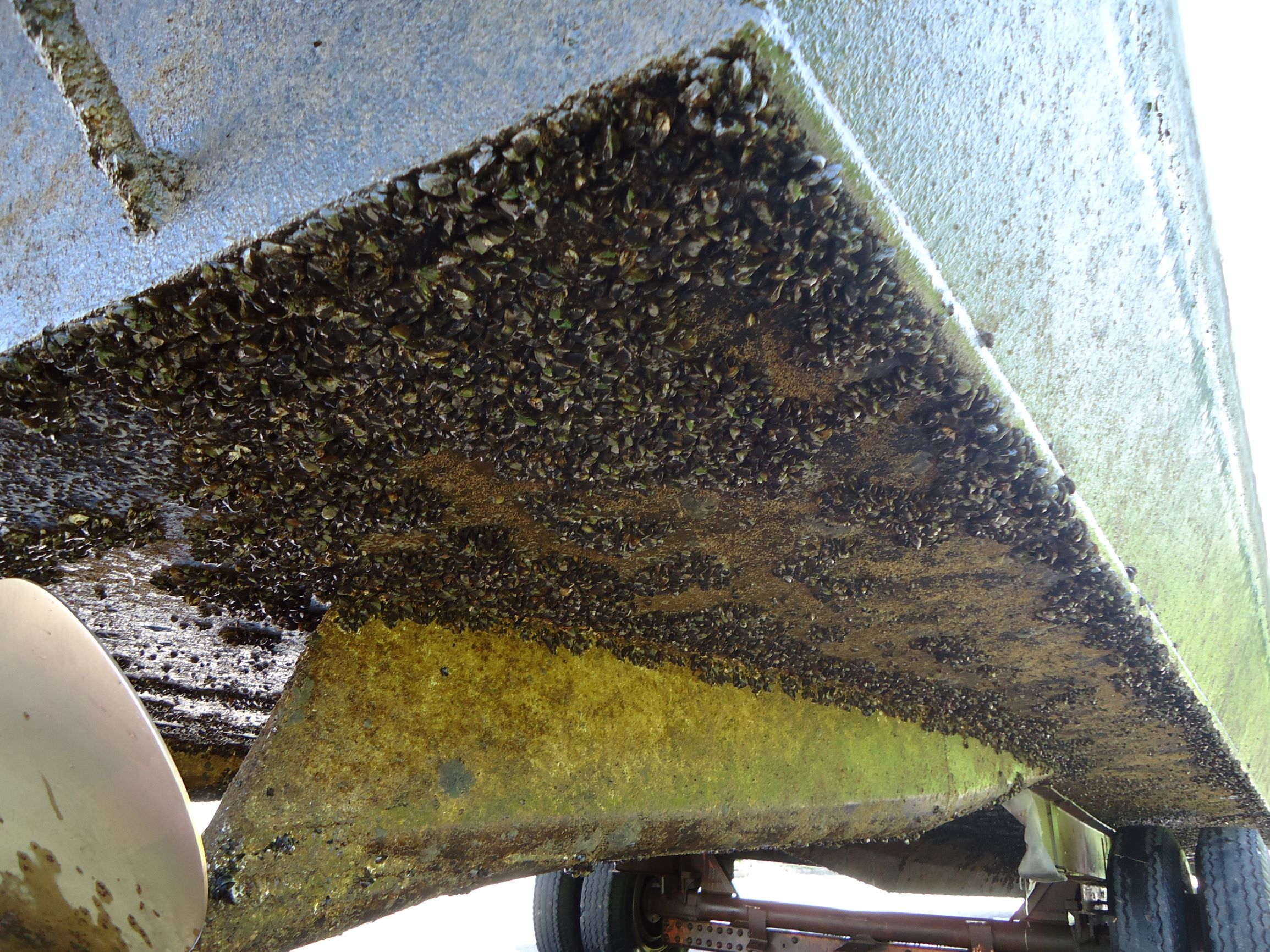

The speed never cross my mind as in houseboats we are lucky with anything over 20mph. The growth thing must be subject to where you boat. I bought my 32 in Cheboygan Michigan, Water so clear I could see the rudders, when we pulled for winter there was nothing to pressure wash....and my bottom paint is white/light grey.
In Pittsburgh Pennsylvania on the Allegheny River, we haul out every year, we do pressure wash, but its not like a heavy growth.
In Louisville Kentucky, Ohio river (Most boats stay in year round) when dad and uncle bought boats HEAVY growth/Zebra Mussels
At Pluckebaum, they scraped the underneath with a shovel first...then pressure washed...now thats bad.

Just a couple Zebra Mussels from the Ohio River, Think that would slow you down?
