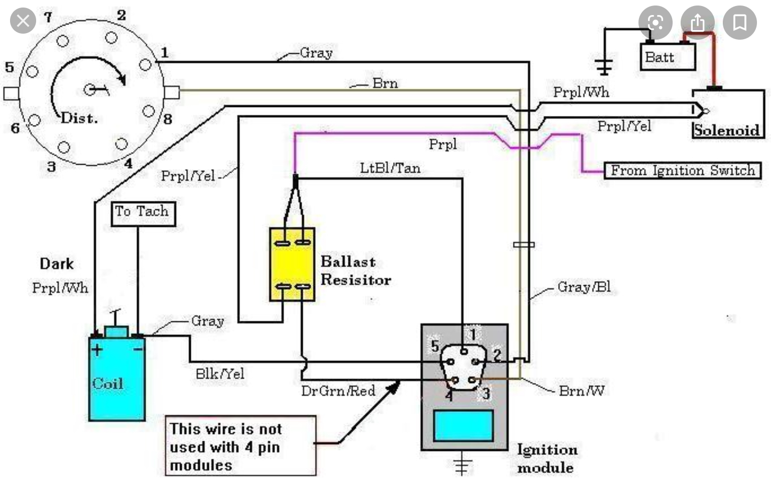

Think you need to upgrade your coil at the same time with an internal resistor. Then wire directly to coil and key - throw external resistor and ignition mod in the trash.

Leviathon wrote:Think you need to upgrade your coil at the same time with an internal resistor. Then wire directly to coil and key - throw external resistor and ignition mod in the trash.
I want to make sure I understand 100%. I grabbed this wire diagram off of another post. My understanding is that I would wire ignition switch to the positive side of the coil. Positive wire of the pertronix to coil. Then remove the existing ignition system and the wire to the starter solenoid.

You have a black and red coming from Pertronix Dist. Black goes to negative side of coil, Red goes to positive side of coil . From Key - you should have ST or S and ING or I. The S goes to starter solenoid, the I goes to positive side of coil. So the "I" wire and the Red from Pertronix both go to positive terminal on coil. I used the "Flamethrower" coil them recommended, but I think any 12v coil with internal resister will work. It sound like you have it figured out in your description above. - will look a lot different than the pic of the old system. Good Luck!
