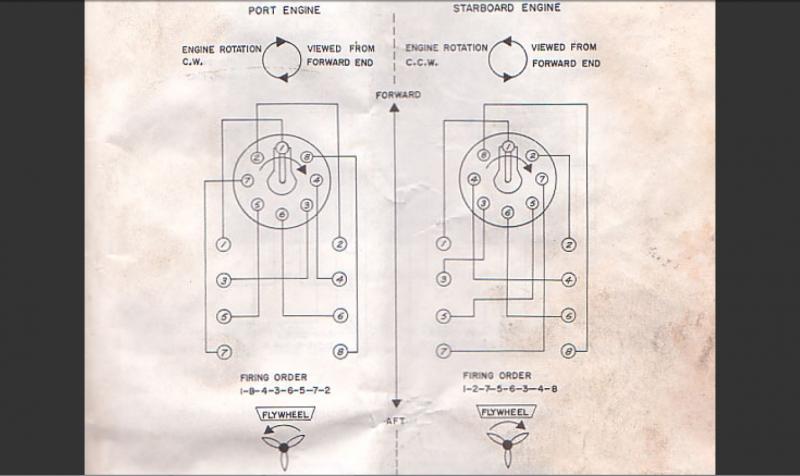

I have had a problem ever since I rebuild my boat. The starboard engine is weaker than the port. The Port engine I rebuilt. I had it bored to .30 over (because of cylinder rust). And had the valves dressed up. The starboard engine had been sitting for 6 years with water in the oil form a blown exhaust manifold. The cam was rusted up and the pistons seized up. I purchased an Grooms re-manufactured long block. Both engines have new Mallory distributors and New Carburetors. I cannot hear any differences in the engines. The Starboard engine seems have a less powerful in noise.
Wide open throttle Port 3750 RPM Starbord 3400
Wide open throttle with other engine idle Port 3100 Starboard 2700.
At synced at 2500 RPM the Starboard throttle significantly more than the Port. I have a flowscan the Port engine is using 2-3 gallon per minute more gas.
I have swapped the carburetors - no change
Played with timing - no change
I am going to pull the spark plugs and inspect each one and then do a compression check.
I am worried about the quality of the re-man engine. The valve leaking or an cheap or wrong cam grind.
Has anyone else have one engine stronger than the other? Is it the Starboard reverse rotation?

Just went through that with Mr Port. In its case, a plug wire (or two) was bad. (And when I changed the wires, one lead fell off. Doh!)
Here's what to do (and it won't be pleasant): Run the boat hard, then shut the motor down as fast as possible--NO idling allowed! Then, soon as it cools down, pull all the plugs and eyeball the colors. If they are all similar, fine; if one or two are different colors, there's where to start looking.
PS: The 'mechanics' at my former marina switched two plug wires (not hard to do considering the crappy way Mopars are wired). Motor popped a bit planning off and was down about what you are seeing. Cost me a whole bunch of effort trying to figure out why, and didn't do the motor much good either.

My boat also had spark plug wires incorrect. Be sure you check firing order is correct on ignition cap. Trace all wires! :mrgreen:

When I rebuilt the PORT and installed a reman in the STARBOARD I installed new Mallory marine distributors with Magnetic breaker less ignition, Mallory Coils , new plugs and wires. They now have 100hr them. Checked compression 125-135 PSI. Looked at the plugs OK. Triple checked the wires and firing order.
@#$#^$#%^@$# I blew my ignition module in the distributor. I unplugged the distributor when checking the compression. My mistake was I pugged the distributor back in with the ignition on. $100 Amazon am my motor is down till I receive the new module.
I think the difference may be due the remanufactured engine. The remanufactures re-grind the old cams. If it is not done correctly can distort the lift, duration or timing of the valves.
