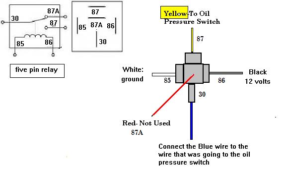

You need to remove ALL of the alarm connections (Oil pressure and temp switches) on both motors. Then, with both running, put them back on one at a time until the alarm goers off.
Pain in the tush, but that's the best way.
PS: All 6 of my temp switches use automotive style quick disconnects to make this task easier. I also separated the two motors alarm system so I can run either one alone (without the low oil pressure alarm on the other setting the alarm off). This required two simple relays and a bit of wiring. If anyone is interested, I can post photos and the schematic.

No problem. I use a couple of simple relays I go on eBay (about ten bucks).
Here's the wiring diagram.

Thanks Fastjeff for posting the diagram. That looks like a good project for the future.
