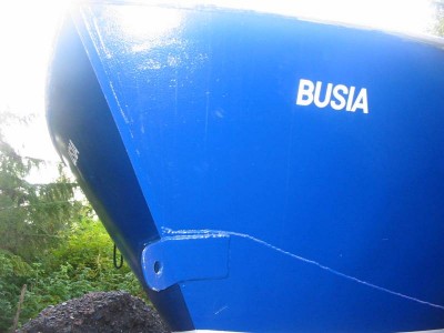

Re: Bow eye question
Here's what I made for mine. I was putting a new bottom on so put an eye on too. I can pick the front of the boat up with this eye.
