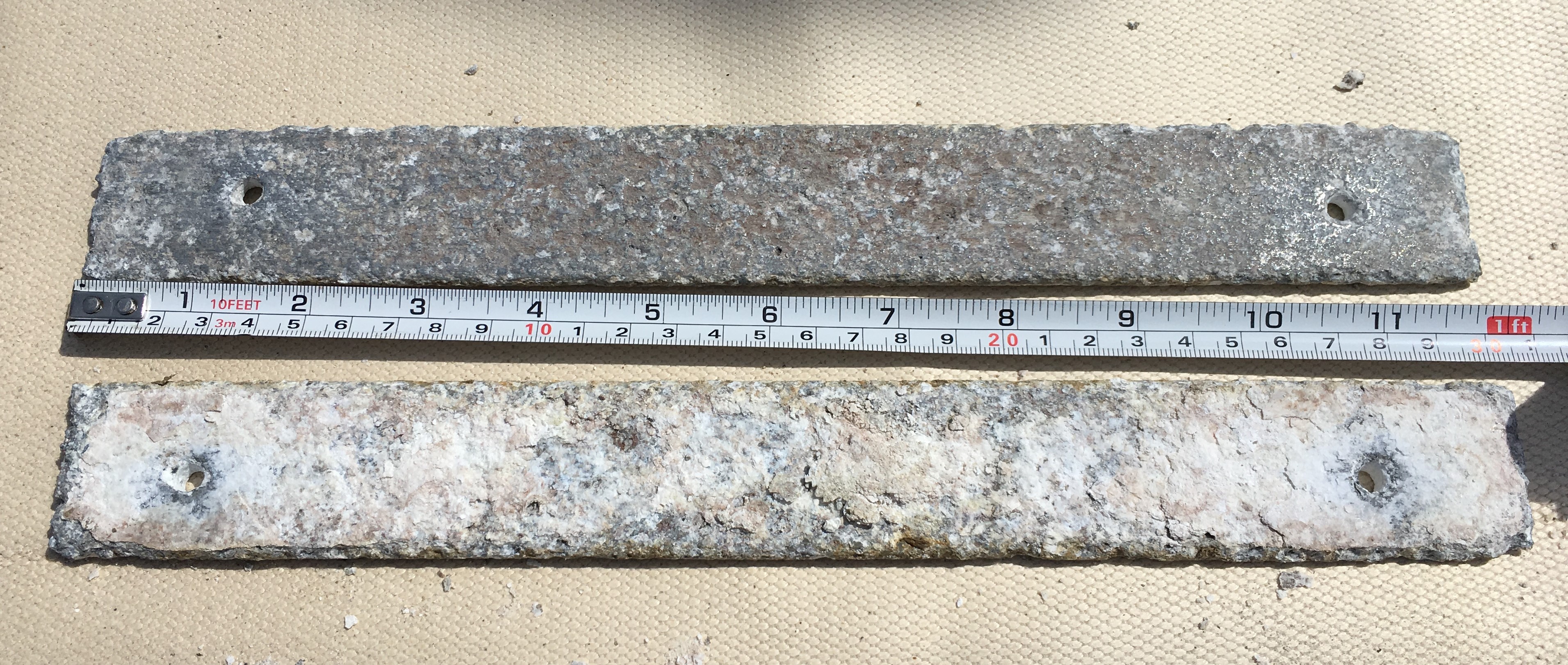

The following are pictures of the trim tab anodes that I plan to clean up and reinstall. The top anode has been cleaned a little. The bottom shows the corrosion on the tab contact side. What are your thoughts? What if I added another?

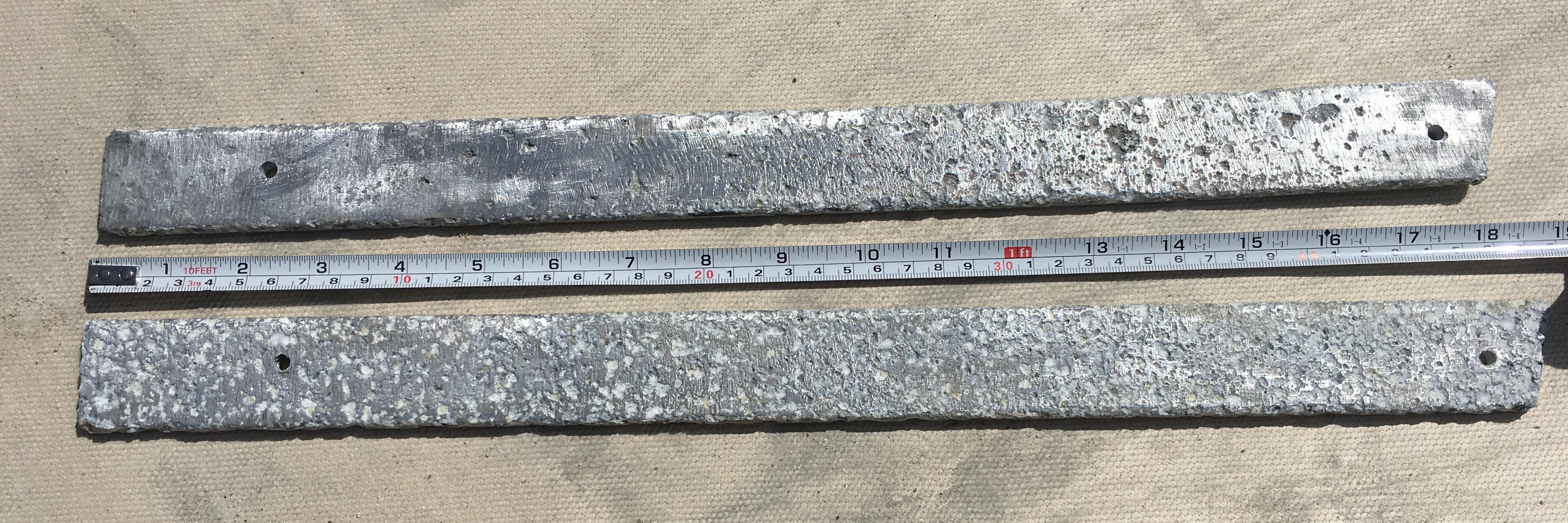

This is the Keel & anodes.... How much life do you think that they have?
Should I drill a hole in the center for another contact point?
There are 4 of these. The other 2 are in much better shape. They must be newer.

They look a little rough but if you cleaned them off with a stiff stainless wire brush they would probably still have some life left to them. Additional contact points cant hurt.
The general rule is that anodes are dead after 50% or more of their original material has worn away.
If you decide to go with new ones, here's a link to the Marinette anodes on boatzincs.com. It's one of the best places to get anodes. Good prices.
http://www.boatzincs.com/marinette-bar.html
For a 28' BigM , 1 of those 3-foot strips on each side of the keel is good. There should also be small anodes on the rudder(s) and trim tabs.

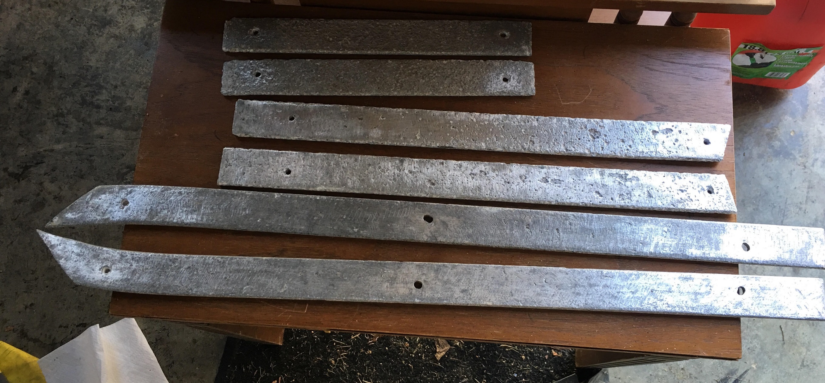

The cleaned up anodes.

Here are the cleaned up anodes...

You're on the right path. Anodes are not worn past 50% (and recall that when mine did get worn, I put two worn ones together to equal one solid one. I don't think you need to drill more holes. Clean the keel behind the anodes (no paint) and bend them outward just a tad so when you tighten the bolts the anode to keel contact is firm. Done and protected.
