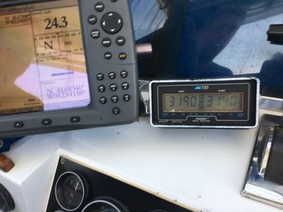

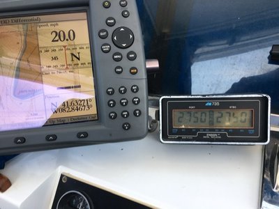

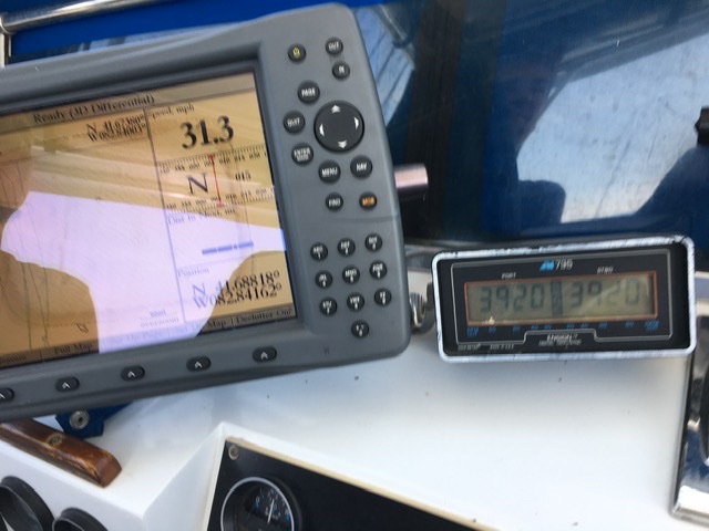

29 mph on the GPS at 4,000 rpm. Please note I have full iesenglass on the fly bridge, large batteries for my house setup that weigh 410 lbs, 6.6kw generator. Etc. I am looking to try different props next year. Running 16 x 15 three blades presently. 1:52 × 1 trannies.

That is very good performance - 29 mph at 4,000 with a lot of wind resistance up top and extra weight below. We had a similar boat with 318's, same props and trans and settled for 24mph at best.
